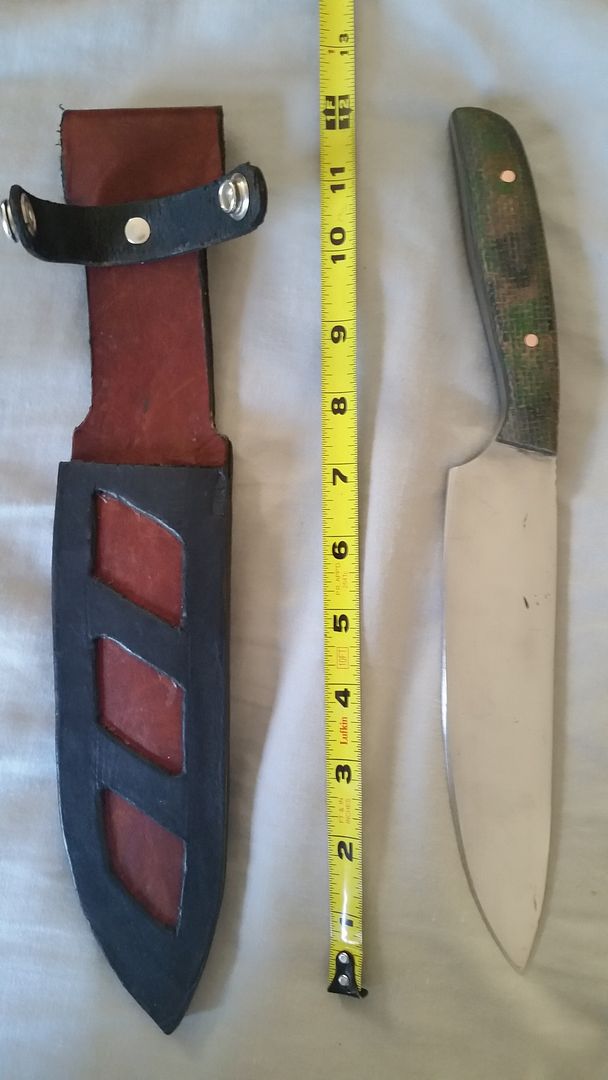

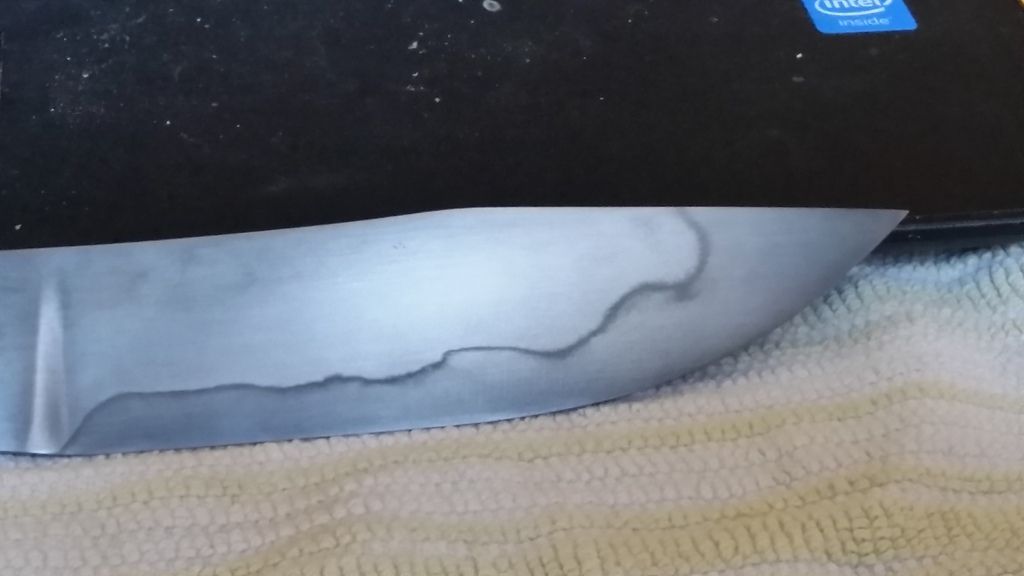

Last time I was here I posted some stuff I was working on, well I finished some broke one and rebuilt my forge.I'll just show you.

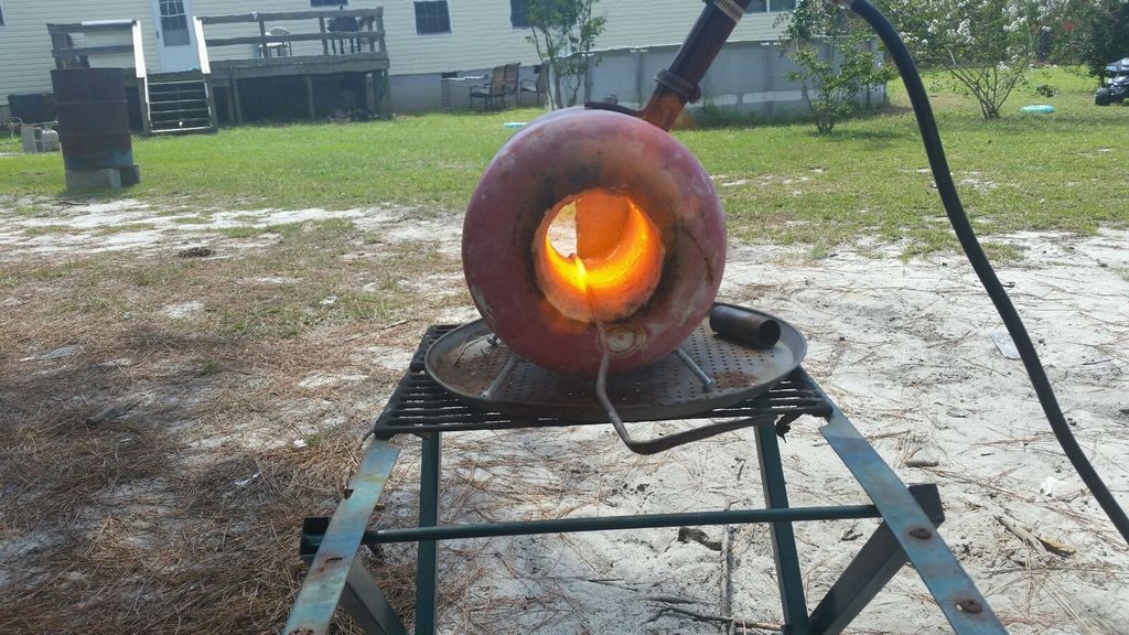

That bowie I was working on devlopement a crack that I determined was a result of uneven heating on the heat treat so I built another forge, a pass through this time

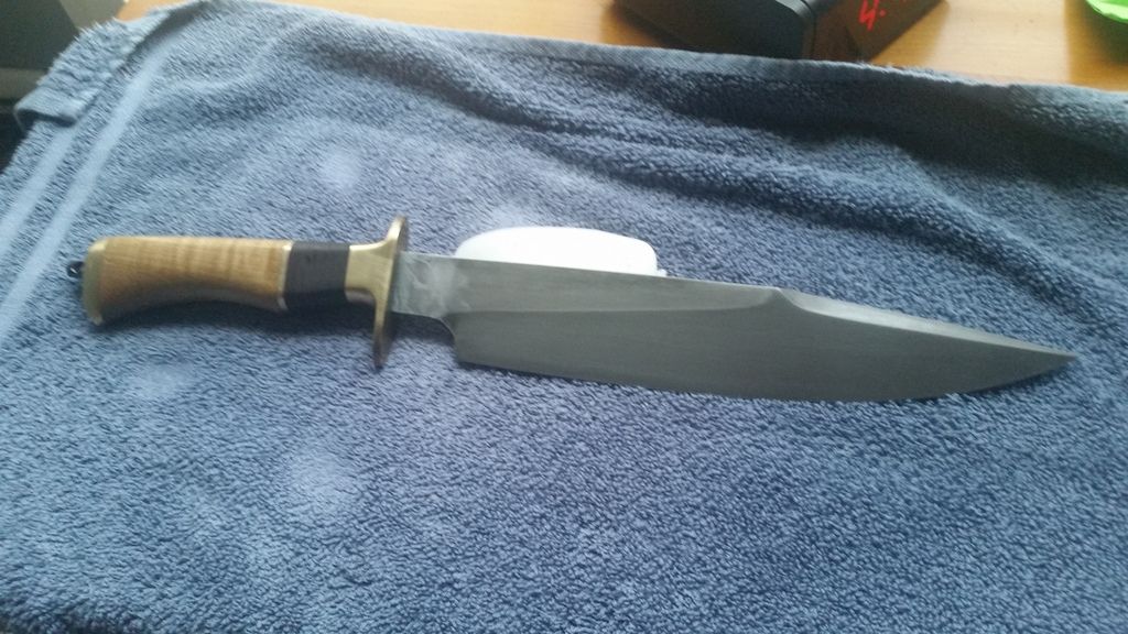

It works much better than the precious so I got busy on another bowie thus time with some success.

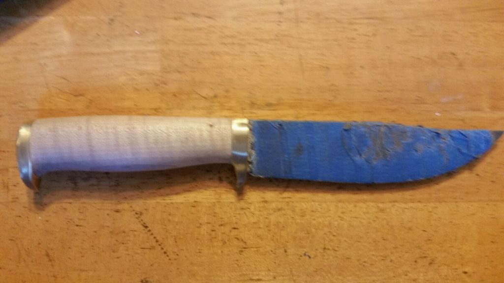

This next one I don't have a finished pic of but the handle turned out really well fiddle back maple

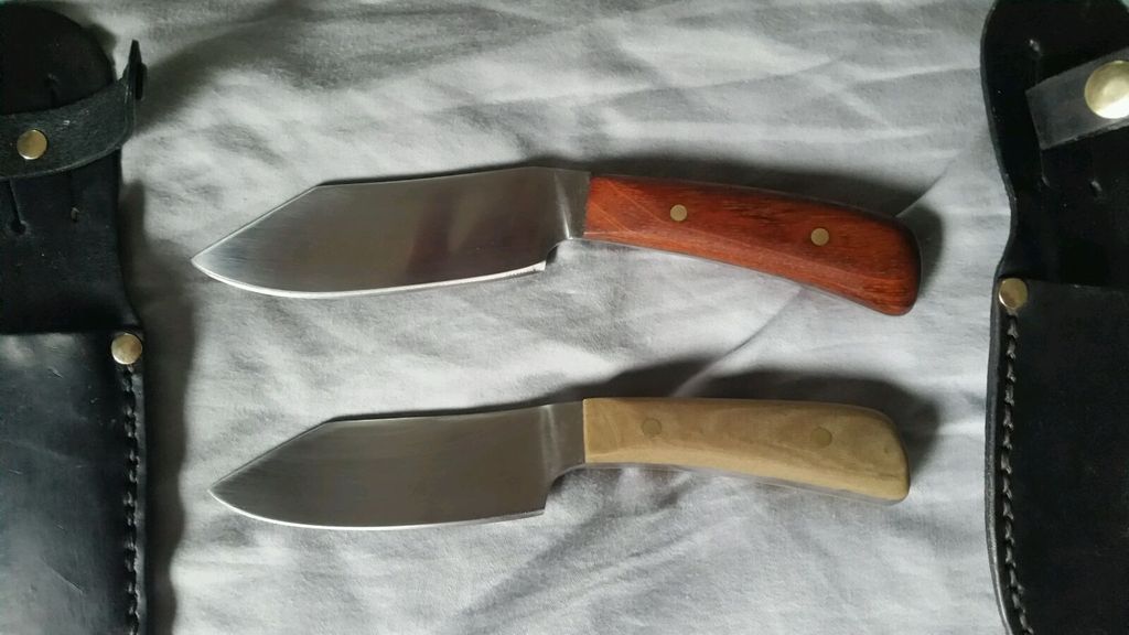

Here's two of the skinners, brazillian cherry and linen micarta
I haven't finished this one but I managed to pull a pretty good hamon out of it
Made this for the grandmother in law, she had been wanting a cleaver for chopping barbecue for a while, she liked it

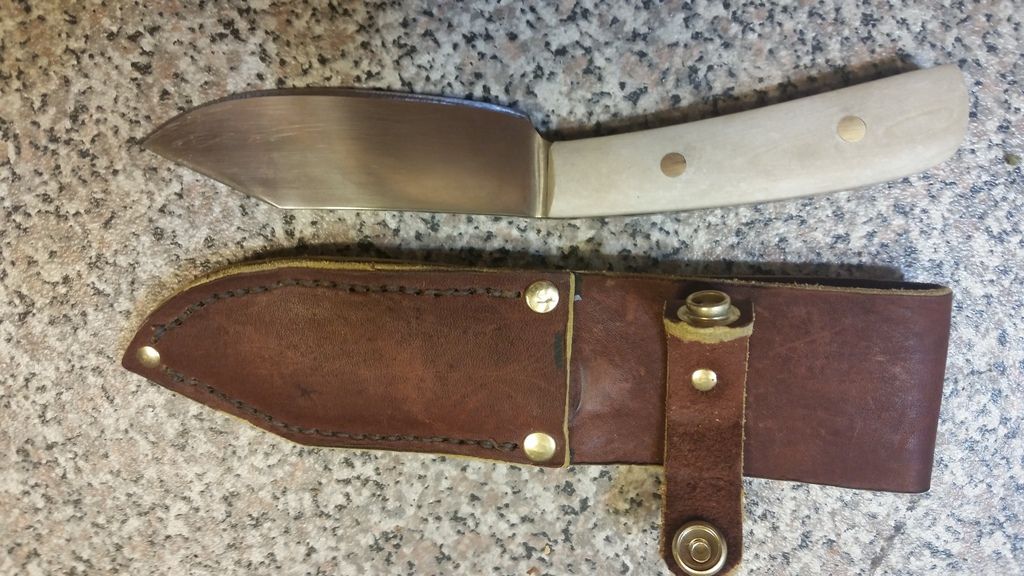

Give this to a good buddy of mine at work, handle is paper micarta white cardstock with black for a liner
 And this a camp knife I'm traded to a guy for more spring steel, burlap micarta camo
Yeah I got it real bad now, between work and this the wife hardly sees me, which may or may not be a bad thing for her.

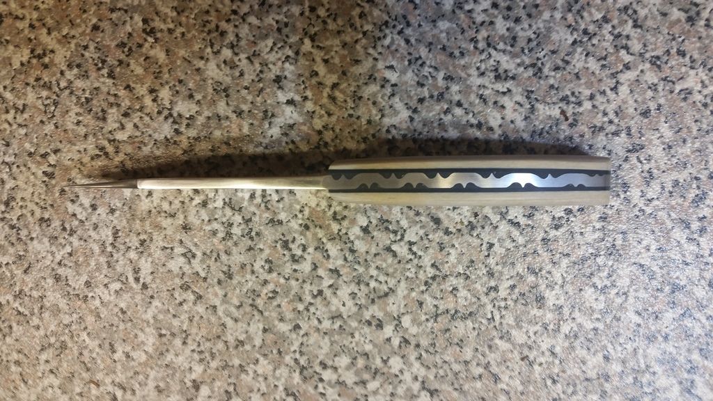

How do you get that wave pattern in the tang?  Beat it against a mold?  CNC machining or magic?
And the black stuff under the wood grips, epoxy or?
Its suppose to be a vine and thorn pattern, I wish I had a better pic of it, but a chain saw file and triangle file it's not really hard just takes a little time
Quote
Nemo
I add powdered graphite to the epoxy  and really slather it on so it squishes out and fills the holes.
